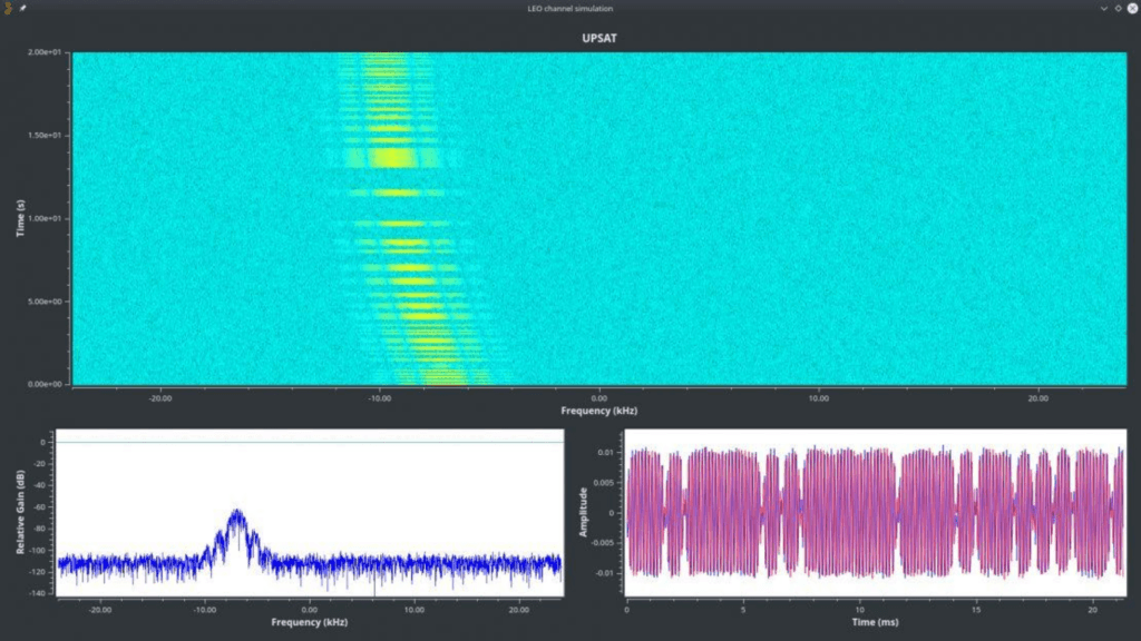

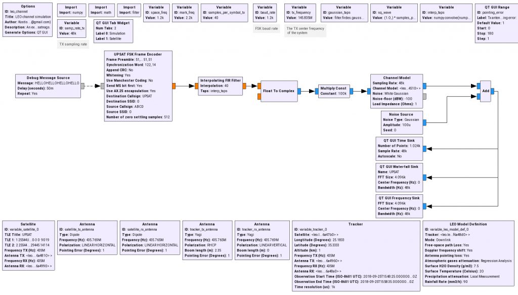

Below is an example of a UPSAT flowgraph combining gr-leo and the UPSAT transmitter. Both are included in the gr-satnogs module.
UPSAT gr-leo flowgraph
UPSAT Transmitter
By using the gr-leo module with the GNU Radio Companion integrated blocks we succeed in:
  • Defining a satellite and describing its orbit by providing a valid TLE.
  • Defining a tracker by specifying its coordinates, the operating frequencies, the antenna type and an observation time-frame.
  • Defining the communication channel model and specifying the desired attenuation types which need to be simulated.
Once these parameters are specified, the channel model block attenuates the input signal according to the defined channel model and the orbit of the satellite described by the TLE.
