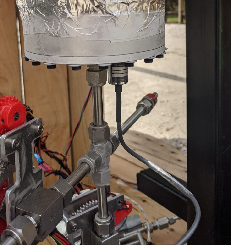

Reaching the First Significant Milestone: A successful Cold Flow Test

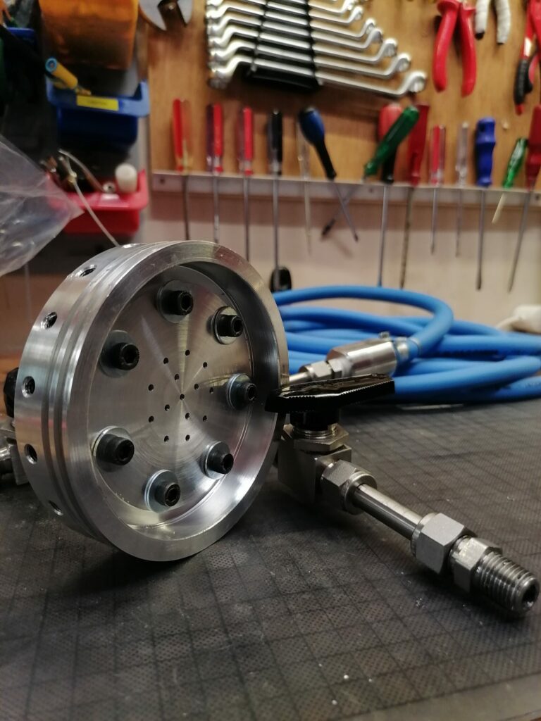

After two long years of continuous tinkering, the time was ripe for the White Noise team to run the first Cold Flow Test of the Cronos’s rocket engine at the end of March 2022. In aerospace engineering, Cold Flow Testing is a significant step in the manufacturing process of a rocket; it is the testing of the rocket’s engine without firing it. This test is performed to validate the integrity of the engine’s injector, the part that atomises the oxidizer and feeds it to the combustion chamber.
The Cold Flow Test: Important lessons learned
The White Noise team of University students organised, ran and brought to completion successfully the first Cold Flow Test of Cronos’s engine. With it, Cronos became the first hybrid-fueled sounding rocket to have achieved that in Greece and thus, the White Noise team reached a new, noteworthy Milestone. Following the steps of the process with great care and precision, taking all the necessary safety measures and showing outstanding professionalism in organising and carrying out the Testing from start to finish.

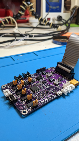

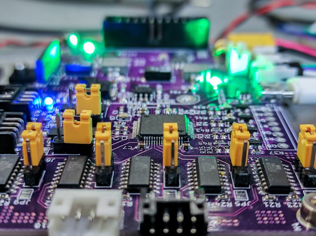

At the same time, all the different groups within the White Noise team are working on their sub-projects about Cronos. They have been focusing on testing and debugging the latest addition of PCBs.
PCBs are considered to be among the most complicated parts of a rocket. This is because they are responsible for handling data from a wide variety of sensors and deciding upon the progress of the launch sequence.

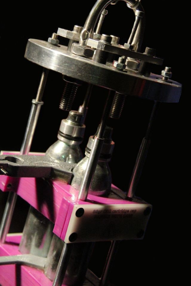

The team has also been working on manufacturing the carbon fibre and fibreglass composite parts of the rocket’s outer body tubes and fins; as well as testing and continuously verifying the proper functionality of the rocket’s CO2 recovery system. They have also been upgrading their communications and reach-out strategy and finding ways to network with other teams and promote knowledge. All the working groups have been collaborating closely, running all the processes successfully to create Cronos, turning it into an aspiring educational initiative. The team has been aiming at making the sounding rocket the test platform for exploring future possibilities of building more advanced rockets capable of reaching higher altitudes-designed and manufactured in a collaborative and participatory way.
